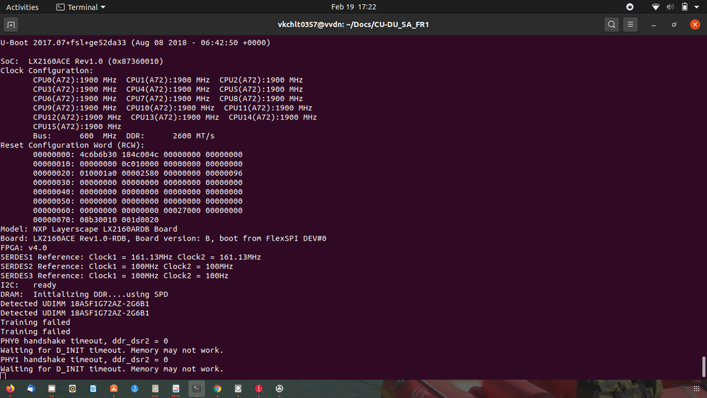

I am currently using LX2160A-RDB board . The board is failing in the U-boot sequence immediately after detecting the DDR.("Waiting for D_INIT timeout. Memory may not work."). I tried with different DDR with the same clock frequency,but still the error is showing .Is there any suggestion in why this is happening?? How can this issue be  resolved?image.pngimage.png

ufedor
Firmware which you programmed has RCW setting 2900 MT/s data rate, but installed modules support only 2600.
Please try attached firmware.
12,600 Views
diljithka
I used the attached  firmware , but still board didn't came up.
Screenshot from 2021-02-19 17-22-36.pngScreenshot from 2021-02-19 17-22-36.png
12,588 Views
ufedor
According to the log the last firmware image is the same as it was originally.
It seems that the processor was damaged (may be by a ESD).
