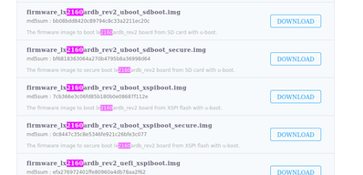

Please use CodeWarrior and re-program composite firmware binary image available at:
https://lsdk.github.io/components.html
section LSDK IMAGES (for silicon Rev1.0 use LSDK 20.04 or earlier).

In the link provided https://lsdk.github.io/components.html there is no image for REV 1.
Screenshot from 2021-02-18 16-40-18.pngScreenshot from 2021-02-18 16-40-18.png
Use drop-down selector at the top of the page:
