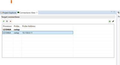

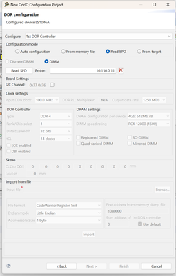

I have a custom board based on LS1046A, with a DDR4 SODIMM and I am validating a new DDR4 module using the DDR validation tool. However, I can't read the SPD from the CW. The SPD_EEPROM_ADDRESS is 0x50, and SPD_BUS_NUM is 1.
I have checked  C:\Freescale\CW4NET_v2020.06\Common\QCVS\Optimization\resources\QorIQ\ARMv8\templates\ddr\system_config_params_read_spd.json, The 0x50 is listed here but I cannot find a place to set the bus number.
        "in" : {
            "spd_eeprom_addrs" : "0x50 0x51 0x52 0x53 0x54 0x55 0x56 0x57",
            "i2c_mux_addrs" : "<<{I2C_MUX}>>",
            "i2c_mux_ch_default" : "0x8"
"Read SPD" from DDR configuration tool does not work.  Probe connection is fine.
