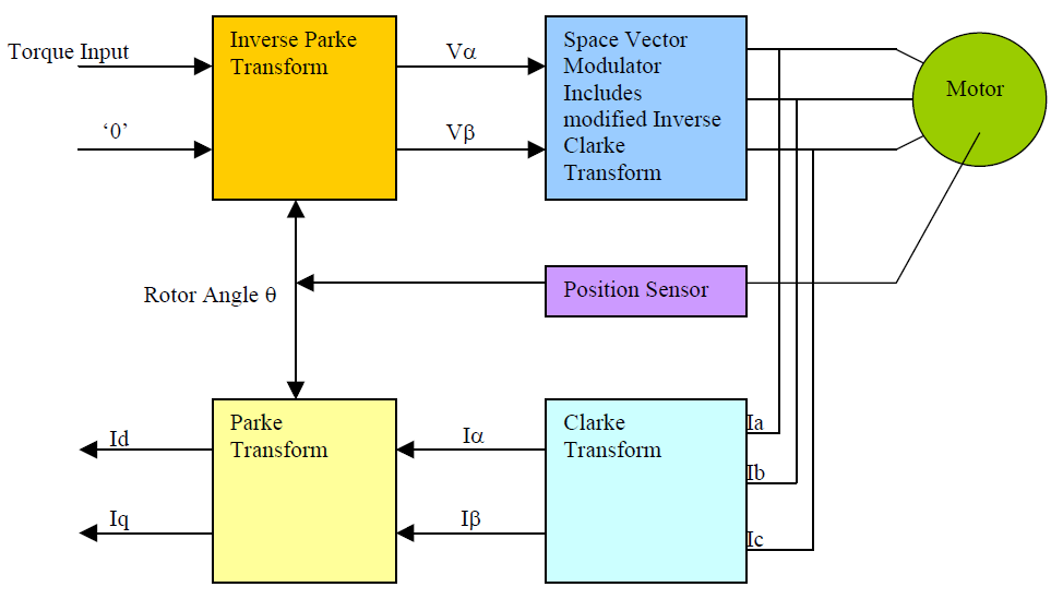

The LPC1549 PMSM motor control solution provides a Field-Oriented Control (FOC) example to get you started with motor control prototyping. This example utilizes the QEI feature on the LPC1500 to monitor the position and velocity of the motor for both sensor and sensorless modes. The additional advanced features of the LPC1500 including the SCTimer/PWM and high speed ADC ensures easy and reliable control of time critical peripherals, and a mechanism for sychronization of the ADC's with the PWM for exact timing of the sample moments.
FOC is a more advanced approach where each phase is driven sinusoidally and permanently powered so the magnetic field inside the motor is regulated to the most optimal value.  The project is implemented on the LPC1549 PMSM Motor Control Kit, which includes an LPC1549 LPCXpresso board.

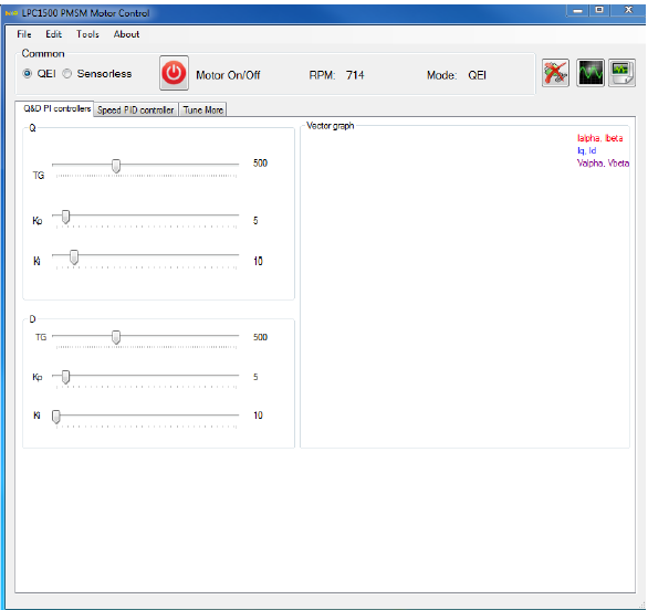

This solution also comes with a GUI interface, which is developed to tune motor parameters in FOC firmware.
                                        FOC Control Block Diagram
                                                   GUI Interface
