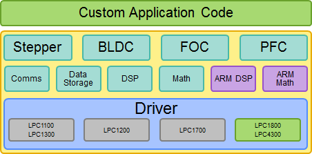

Library layers
The motor control library is separated in four layers. The bottom layer contains the peripheral drivers. On top of the driver layer is a generic collection of control algorithms to drive the peripherals. On top of that resides the layer that defines the motor control type and contains the state machines to drive the specific type. Finally there is the application layer that determines the interfaces to the library and initializes the application specific motor control type, peripheral setup and interconnection.
