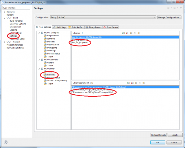

1. Add the IOH library (libioh_*lpcxpresso.a) to the project
The first step is to configure the LPCXpresso project to link against the IOH library. Open the project properties. Browse to 'Settings', then 'Libraries'. Add the library name (minus the 'lib' prefix) to the first box ('Libraries (-l)'), the library location to the second box ('Library search path (-L)').

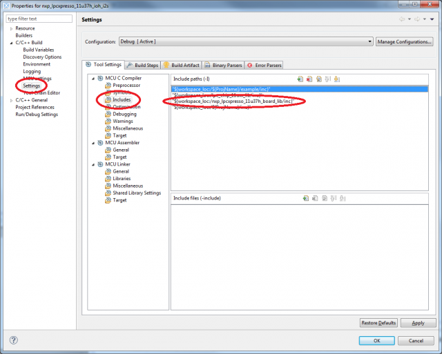

2. Add the path where the library's header file resides to the project’s include path
The next step is to add the file location of the library's header file to the include path of the project. Still in the project properties, browse to 'Settings', then 'Includes'. Add the location to the 'Include paths (-I)' box.
