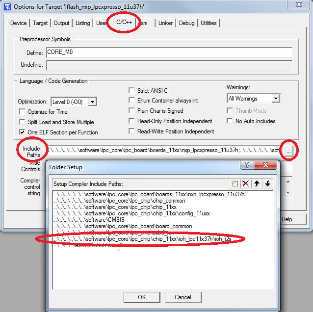

2. Add the path where the library's header file resides to the project’s include path
The next step is to add the file location of the library's header file to the include path of the project. Open the project options and browse to the tab 'C/C++'. Add the location of the header file to the 'Include Paths'.

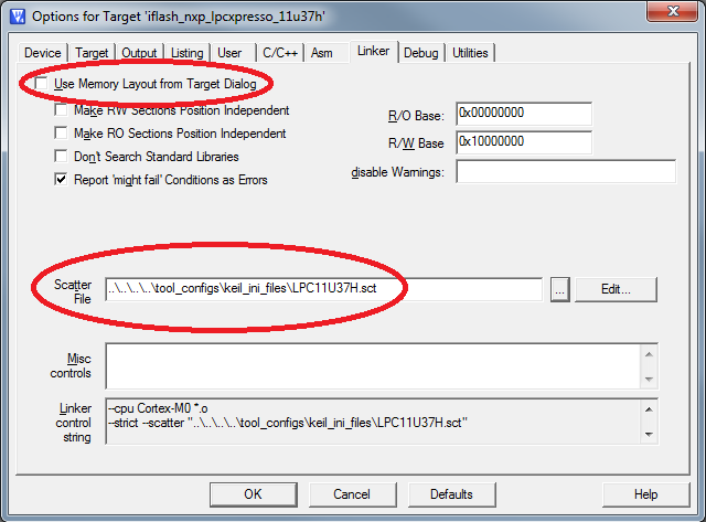

The linker script can be added to the keil project by opening the projects options and browsing to the 'Linker' tab. First uncheck the 'Use memory Layout from Target Dialog' checkbox, then add the file location to the 'Scatter file' box.
