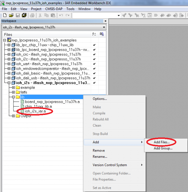

1. Add the IOH library (ioh_*_iar.a) to the project
The first step is to configure the IAR project to link against the IOH library. This can be done by simply adding the .a file to the project.

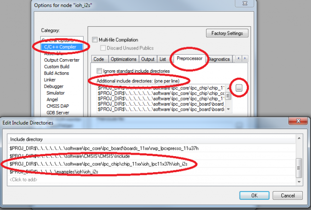

2. Add the path where the library's header file resides to the project’s include path
The next step is to add the file location of the library's header file to the include path of the project. Open the project options and browse to the category 'C/C++ Compiler', then to the tab 'Preprocessor'. Add the location of the header file to the 'Additional include directories'.

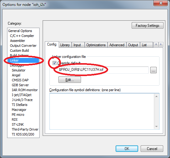

4. Configure the linker to place the IOH related sections in the IOH SRAM
All IOH parts have an SRAM region reserved for I/O Handler. When starting IOH, usually by calling the library's init() function, I/O Handler expects this memory region to be loaded with the IOH data provided by the IOH library. This means this data must be stored in Flash and copied to the IOH SRAM upon startup. A convenient way to do this, is by using scatter loading. With scatter loading, the linker and c-library are instructed to program certain data sections (IOH data) into Flash, and copy it to the specifed region (IOH SRAM) upon start up. This requires a linker script.
The linker script can be added to the IARproject by opening the projects options and browsing to the 'Linker' category. First check the 'Override default' checkbox, then add the file location to the 'Linker configuration file' box.
Following is the part of the linker script used for the LPC11U37H, responisble for placing the IOH sections in the SRAM1 region (IOH SRAM):
