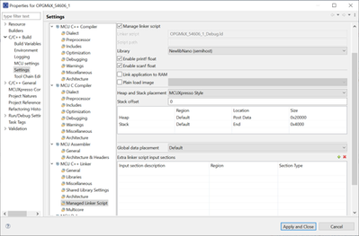

I am working wih LpcXpresso IDE and have problems to use the function sprintf() with float conversion. A lot of hints are available in the internet (e.g. uses -u _printf_float). But I do not know, how to handle this. Can anybody give me a solution?

For me I found something in the linker settings. Project Properties.
checkboxes for printf and scanf floats.
- this seemed to work for sprintf too.

So is your project configured to use Redlib, Newlib or NewlibNano as your selected C library?
What are Redlib and Newlib?
If you are using Redlib, then make sure you haven't got CR_INTEGER_PRINTF symbol defined:
Using printf()
And if you are using NewlibNano, then make sure you have "Enable printf/scanf float" enabled in Project properties:
Newlib-Nano Support
If you need further assistance, then please confirm the version of LPCXpresso IDE that you are using, and export and post an example project that shows up your problem:
