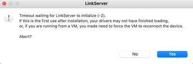

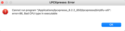

I have dusted off my LPC4088 dev board and am trying to run an example but I am having trouble.  I am on macOS Big Sur and also have a LPC-Link2 debugger attached via JTAG.  When I try to debug an example or try to program the flash I receive the following errors relating to the dfu-util and and the LinkServer:
Screen Shot 2022-08-29 at 10.26.58 PM.pngScreen Shot 2022-08-29 at 10.26.58 PM.png
Screen Shot 2022-08-29 at 10.31.13 PM.pngScreen Shot 2022-08-29 at 10.31.13 PM.png
It seems like the board is recognized: 
> system_profiler SPUSBDataType
 LPC:
          Product ID: 0x000c
          Vendor ID: 0x1fc9  (NXP Semiconductors)
          Version: 1.00
          Serial Number: ABCD
          Speed: Up to 480 Mb/s
          Manufacturer: NXP
          Location ID: 0x14200000 / 11
          Current Available (mA): 500
          Current Required (mA): 100
          Extra Operating Current (mA): 0
Any help would be appreciated.
UPDATE: I tried switching to MCUXpresso and everything seems to be working now.  Unclear if a reinstallation of LPCXpresso would have worked but a fresh install of MCUXspresso worked.

Hello eblas,
Thanks for your sharing, and recommend use MCUXpresso IDE, the  LPCxresso IDE is legacy took, won't provide update and any patch.
