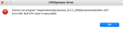

I have dusted off my LPC4088 dev board and am trying to run an example but I am having trouble.  I am on macOS Big Sur and also have a LPC-Link2 debugger attached via JTAG.  When I try to debug an example or try to program the flash I receive the following errors relating to the dfu-util and and the LinkServer:
Screen Shot 2022-08-29 at 10.26.58 PM.pngScreen Shot 2022-08-29 at 10.26.58 PM.png
Screen Shot 2022-08-29 at 10.31.13 PM.pngScreen Shot 2022-08-29 at 10.31.13 PM.png

UPDATE: I tried switching to MCUXpresso and everything seems to be working now.  Unclear if a reinstallation of LPCXpresso would have worked but a fresh install of MCUXspresso worked.

Thanks for your sharing, and recommend use MCUXpresso IDE, the  LPCxresso IDE is legacy took, won't provide update and any patch.
