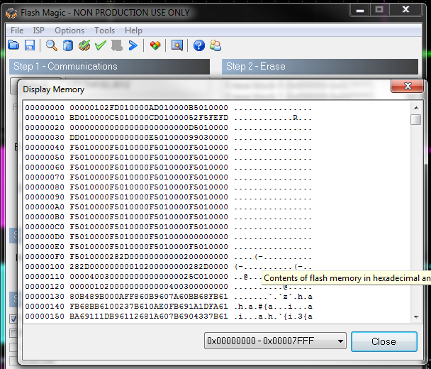

Using the ISP by serial port 0 and Flash Magic application. Is possible to verify that  the firmware was in the internal flash, and using the Verify command it's totally match with the hex file, get from the firmware used on the debug session.
In fact all the Flash Magic commands work's fine. But all the firmware that  I try download, don't start after the download end.

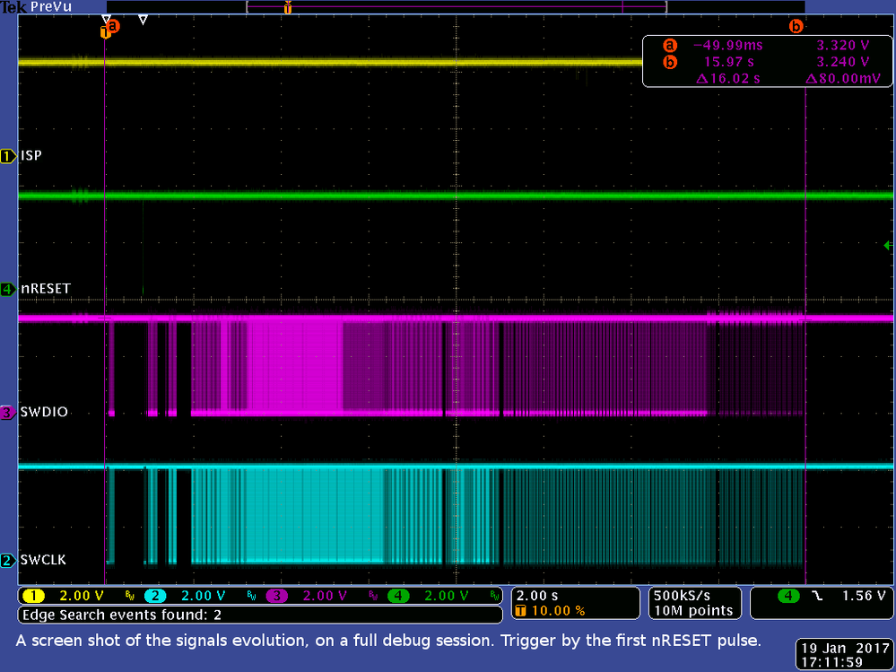

- See the SWCLK, SWIO, nRESET and ISP signals on an oscilloscope. It's looks fine. No changes on the ISP signal when the SW usage. And the  nRESET signal only changes on the begin of the debug session.

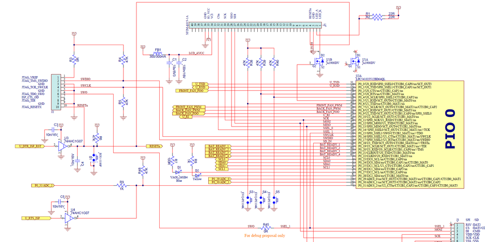

First at all, thank you for your reply, "LPCXpresso Support".
I already double check the design, and I think that is like suggested in the "Design Considerations for Debug”.

And  the debuger "talk" a lot with the chip. The maximum probe clock was limited to 100kHz.
The signals section of flash erasing and flash write, see be OK.
But after, that the debugger lost the communication with the chip, it retry several times before stop.

I note that your board uses R4 and R5 which should not be required as these pins are internally pulled high by MCU.
From your debugger and Redlink logs it can be seen that the emulator is connecting to the core once the fw has been downloaded to the chip and is reset. This is where your code then starts to initialise and here is where the issue appears, ie cannot communicate with core. Are you able to confirm operation of the DTR_ISP_Reset pin which may be effecting chip initialisation sequence with debugger SWD sequence?

In the first place, I suggest that you double check the design of your debug/reset circuitry, as per - https://community.nxp.com/message/630601 and what you are doing with the ISP pins in particular.
