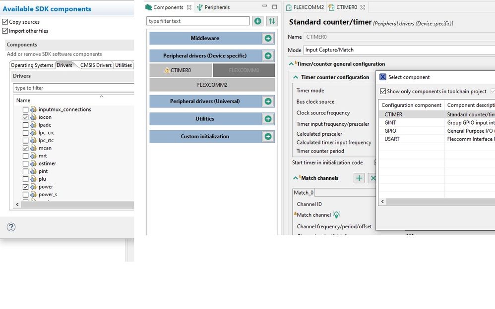

Working in MCUXpresso 11.3.0, I can click on Manage SDK Components->Drivers and select the MCAN peripheral and the .c and .h files are included in the project.
Back in the main IDE, when I click on Peripherals I can't find MCAN anywhere in the "components in toolchain project".  MCAN's absence from this list means there's no snifty high level user interface such as there is for FLEXCOMM, CTIMER, et al.

dougpaulsen
I'm working with the LPC55S16-EVK while waiting for new hardware.  The configuration tool in MCUXpresso 11.3.0 includes the high level interface for FLEXCOMM, for example, but although MCAN is selected under SDK components, there's nothing for Mcan under Peripherals. See below:

Hello dougpaulsen,
Thanks for your sharing, I checked on my side, the same.
It seems the MCAN module for LPC55s16 haven't integrated in to Configuration tool,
I find LPC54628 includes it.
Anyway, I will also take a request to Configuration tool team, thanks.
