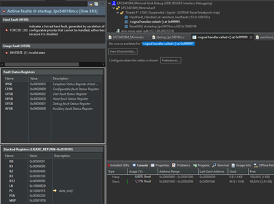

I created a new baremetal project based on the SDK_2.14_LPC54018J4M for my custom board. Without own code!
Running the project as "plain load image" is working but when I set it up as "XIP" i´ll face the following hardfault after the bss_init section.
  • <signal handler called>() at 0xfffffff9"
  • HardFault_Handler() at semihost_hardfault.c:53 0x1000193a
  • UFSR INVSTATE

Hello @ronwal
How about import a SDK demo with XIP?
Alice
2,251 Views
ronwal
@Alice_Yang
I tried that, but it´ll show the same hardfault!
2,213 Views
Hello @ronwal
Take video show your detail steps.
