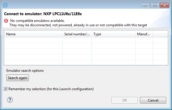

Gentlemen,
my system is Windows7, LPCXpresso 8.1.4, fresh installed. I also bought a brand new OM13058 LPC11U68 Xpresso v2 board, rev.C
The board comes with a built-in example, the blinky. It works properly.
I tried to modify the source of this blinky project. It compiles without error.
When I try to download it, LPCXpresso cannot connect to the debugger.
JP3: Link DFU is removed, I also tried it connected, same result.
JP1: removed.
JP2: 1-2 is connected.
On the Start -> Devices and Printers, nothing appears.
I installed LPCXpresso with all the defaults, just clicking "next, next".
My computer is rebooted after the installation.
I do not find information about manually installing the necessary USB driver. Is it possible?
What else may I try to have this board work?

So - as recommended in the Troubleshooting section of the "Booting LPC-Link2" FAQ previously referenced - does removing all other non-essential USB devices, such as your USB-serial device make any difference?
Also, try connecting via a power USB hub (or directly to your PC if already using a hub).
And just to confirm - which USB socket on your board are you plugging your USB cable into? It should be the lower one as shown at LPCXpresso Board for LPC11U68|NXP  (and  typically labelled LINK on the board itself).
Note - When you connect this to your PC, you would also expect to see at least one, non-blinking, LED come on (typically labelled PWR).

Ohhh, my God ...
It was the other USB connector what I tried.
I also tried this lower one before, but now, it required roughly 2-3 minutes for all the necessary driver installation. It was 5-6 different one ...
This 2-3 minutes solved the problem, this time is, what I didn't wait before.
All this stupid failure could be due to the earlier experience with LPCXpresso 1769 board, it has only one USB connector, at the middle of the board edge :-) and it immediately worked when the first time connected.
Thank you for the help, and I'm sorry to waste your time.

jeanvaljean
For the FAQ Booting LPC-Link2: This board is brand new, it has never worked before.
In the Windows devices and printers section, I do not see any LPC devices.

In windows device manager, I do not see any LPC or nxp USB devices. All are from Intel, Microsoft, one is from FTDI, it's a USB-Serial converter.
9,728 次查看
avt
so your PC does not see link2 on USB. Try a different USB port and different USB cable.
9,728 次查看
jeanvaljean
Thanks, I did it at the very beginning.
I even tried on another computer, with the same results.
I also tried to add the driver manually, but it failed.DeviceManager.pngLPCDebug.png
