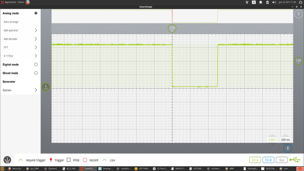

If I try to use the hard reset signal, it works fine (I checked with a SmartScope, the active low reset timing set with rh is OK and the reset level is pretty close to 0V, see the next figure), but when I use it in the command line, it just resets the platform and it won't proceed with the debug:

A question about the nSRST signal:
  • while using the R-Link debugger the nSRST signal is applied low for some milliseconds while starting the debug connection
  • while using the LPCXPresso debugger, the  nSRST is not pulsed low, evenif I set the vector catch option;
    • the nSRST is forced low only if I set the --reset hard option on the command line, but in this case the whole procedure seems to complete after the nSRST has been applied
  • Q: do you know if the debug connection is expected to activate the nSRST signal?
