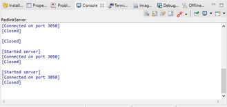

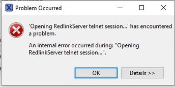

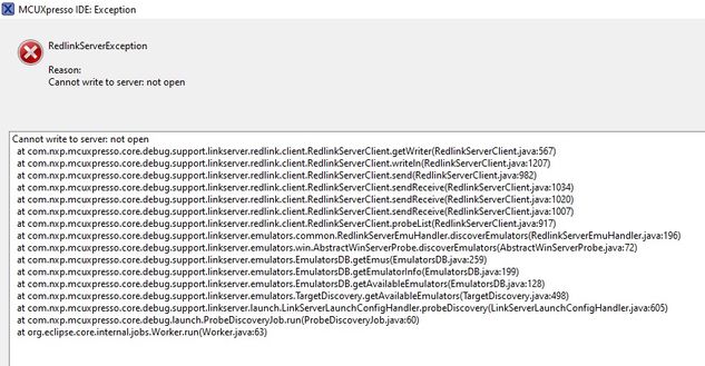

i have a Problem to connect my  LPC55S28-EVK via the On-Board Debugger with MCUExpresso. If i press the Debug Button, loaded the gpio_led_output example before by the SDK, i get the error message "An internal error occurred during: "Opening RedlinkServer telnet session..."".
I saw an older post with the same error, but it wasn't solved.
Thanks, Nicolas

It seems that in your case there is some other application (firewall? FireBird? ) server is using the same port. Therefore, it is blocking access to one of the localhost TCP/IP ports that the IDE is trying to use to communicate with redlinkserv executable. You might be able to identify this using info such as:
https://stackoverflow.com/questions/48198/how-can-you-find-out-which-process-is-listening-on-a-port-...
However, removing one of the ports from the default list in the IDE should not cause any issues as long as at least a couple of ports are free.

It's that! The process of firebird "fbserver.exe" is blocking the port that want be used debugging the project from mcuxpresso.
I don't know how edit the default list of ports TCP from the IDE, but uninstall Firebird was a solution.
