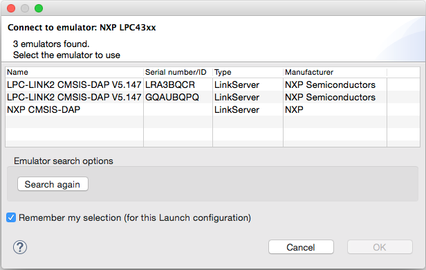

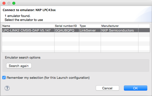

  • when a debug operation is performed, the IDE will display the available debug probes and allow a specific probe to be selected. Future debug connections for a particular project can be set to look for and select a specific debug probe using the Remember my selection tick box. A single LPC-Link2 will display like this:
These changes are specific to LPC-Link2. Other debug probes may be used in combination with LPC-Link2, such as the built in probes of the LPCXpresso CD boards but only the LPC-Link2 probes will be dynamically identified with a unique ID. Two LPC-Link2 probe and an LPCXpresso CD board will display like this:
Note: It may be helpful to label debug probes or boards with their unique ID.

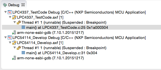

The ability to debug multiple MCUs using a single installation of LPCXpresso IDE can be use in two ways:
Single IDE Instance
From within a single IDE window, you can now debug cores in parallel, selecting which core to step, resume, suspend, etc. by switching between them in the Debug View.
The currently selected core will be the one used for displaying many of the debug related views, such as Registers and Locals. It is also possible to create copies of many of the debug related views, and lock each copy to a particular core.
Note: Although there is no debug logic synchronising debug operations on the two cores, you can select both applications at the same time in the Debug View (typically by using CTRL-Click) and operations like step, resume, suspend, etc will then be carried out on both cores by the debugger in parallel.
This scheme may be most suited to related projects or debug tasks.
