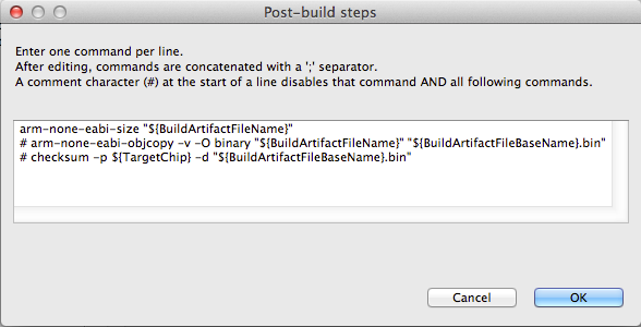

For example, any application project that you create using the Project wizard will have least one such "post-build step" - typically to display the size of your application.
Note: Additional commands may also be listed (for example to create a binary and to run a checksum command), but be commented out by use of a # character and hence not executed. Any commands following a comment #command will be ignored.

  • In the "Post-build steps - Command" field, click 'Edit...'
    • paste in the lines below and click 'OK'
