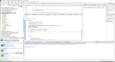

willychou
OK,thank you for your help.
But i have the other questions.
when i used MCUXpresso to run the program,it  appears this error message,but i already check the schemetic.
i use 4 pins,J6: 3V3,GND,SWDIO,SWCLK.
if i want to use this Debug Probe,which pins are nessesary to connect or i need to do some steps?QQ.pngQQ.png

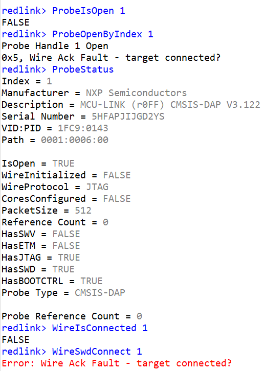

willychou
hello,now i'm using MCUXpresso_IDE v11.8.0_1165. to connect with the board via MCU-Link.
I couldn't able to flash to board. I can see below the error every time.

redlink> WireIsConnected 1
FALSE
redlink> WireSwdConnect 1
Error: Wire Ack Fault - target connected?

willychou
Hello,XiangJun Rong
Thanks for your help,I have solved this problem,it's working now.
I noticed when the probe connected the extension board,Voltage droped to 0.8v,not enough to make program move.
So i connect the other power to supply  Voltage,and the problem has been solved.
thank you so much.
