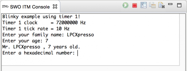

SWO ITM console view
Data written to the ITM stimulus port 0 is presented in this view (as below) . The view shows the ITM console for the active debug session. Text entered into this console is sent to the target if a suitable receiving buffer exists (specifically the global int32_t ITM_RxBuffer).
Note that once the target is terminated the view is cleared.
Within this view, there are the standard start and stop buttons.
  • When ITM trace is started, and data sent from the target will be displayed in this view.
  • When ITM trace is stopped, any data sent from the target will not be captured.
Note choosing to display ITM trace data has no impact on the performance of code running on the target MCU.

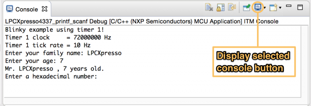

In addition to the standalone ITM Console view, the ITM console is also displayed as part of the standard console viewer . It can be displayed by selecting the “Display Selected Console” button and choosing the console named "<your project> ITM Console". This view persists after the target is terminated, unlike the standalone ITM console view.
Note the standard console viewer switches automatically between consoles to show consoles that are being written to. This switching can be confusing as the ITM console is easily lost among the other consoles displayed there. It is easier to keep track of the standalone ITM console.
