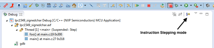

One way to do this is to change into "Instruction Stepping Mode". To do this click on the "i->" icon in the LPCXpresso Debug View.
This changes debug behavior such that you will now step by processor instructions, rather than source lines. It will also cause the Disassembly View to be added to your current perspective, which will display instructions around the current program counter.
If you click the "i->" icon again to return to source stepping mode, the Disassembly view will continue to be displayed.
