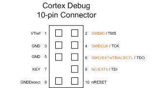

Cortex 10-pin 0.05" JTAG/SWD Connector Pinout
  • Suitable connector headers include :
    • Harwin: M50-3500542
    • Mouser: 855-M50-3500542
    • Samtec shrouded header: FTSH-105-01-F-D-K
  • The 10-pin Samtec FTSH-105-01 connector has the dimensions: 0.25" x 0.188" (6.35mm x 4.78mm).
  • Some boards use un-shrouded 10-pin headers. Always ensure that you connect your cable correctly, typically by matching the "1" marked on the board to the red -stripe on the cable.
  • The 10-pin cable is Samtec part number FFSD-05-D-12.00.01-N
NOTE : LPC-Link2 (in both standalone form and as built in to the LPCXpresso V2 / V3 boards) has the ability to force an ISP reset via pin 7 of the Cortex 10-pin 0.05" JTAG/SWD Connector. For more details see the FAQ "ISP Reset over debug".

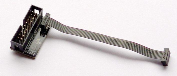

10 to 20 pin adapter
Some debug probes (such as Red Probe+) may be provided with a "traditional" 20-way cable to connect to your board. If your board is only fitted with a 10-pin connector, then the simplest way to connect the two will be to use an adapter to convert between 10 and 20 pins. For example :Embedded Artists 10-PIN TO 20-PIN JTAG ADAPTER
These same adapters can also be used to allow a probe that assumes a 10-pin connector (such as LPC-Link or LPC-Link2) to be attached to a board with a "traditional" 20pin connector.
A similar adapter suitable for allowing an LPC-Link2 to connect to board with a 20pin connector is also available from SEGGER : 9-Pin Cortex-M Adapter
