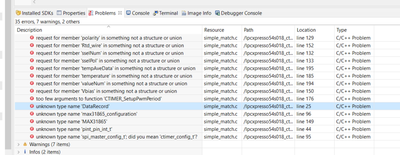

Whole project, that I can directly run on my IDE and board.
Just this code, there is build error.
