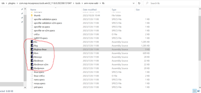

Hello Team,
I am trying to implement a software timer, as part of this, I have used
signal(SIGALRM, event_start_init_callback);
alarm(10); // To invoke the call back handler after 10sec.
But I am getting undefined reference to `alarm' error.
I have included unistd.h. But still linked is unable to find the alarm call.
I verified that, alarm is defined in sys/unistd.h
Can someone please let me know, what I am missing here?

Yes, I know this is LPC Micro-Controller support forum. I am using LPC1768 and Free RTOS is OS.
I am using MCUXpresso IDE v11.8.0_1165
I even noticed, signal.h, and unistd.h are available in below mentioned path.
C:\nxp\MCUXpressoIDE_11.8.0_1165\ide\plugins\com.nxp.mcuxpresso.tools.win32_11.8.0.202306131047\tools\arm-none-eabi\include
Based on that I assumed signals are supported.
Please let me know.
San

Okay, I see.
I suppose that both the signal() and alarm() are not implemented.
You can use timer hardware module for example MRT, systick,sctimer...to implement a fixed period interrupt.
Hope it can help you

Pls try to add the library(*.a) and check if you can find out the binary implementation of the two functions.

This is LPC Micro-controller support forum, as far as I know that the signal() and alarm() functions are Linux function.
Can you tell us the part number you are using? do you use Linux OS for your target board?
