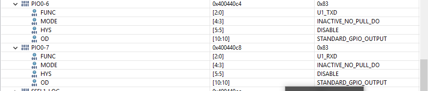

if i debug the next code
   Chip_IOCON_PinMuxSet(LPC_IOCON, IOCON_PIO0_7, (IOCON_FUNC3 | IOCON_MODE_INACT)); /* RXD1 */
   Chip_IOCON_PinMuxSet(LPC_IOCON, IOCON_PIO0_6, (IOCON_FUNC3 | IOCON_MODE_INACT)); /* TXD1 */
Nothing happens in the IOCON register when i do the code above....
if i do this code for the uart0?  this changes the register IOCON
Chip_IOCON_PinMuxSet(LPC_IOCON, IOCON_PIO1_6, (IOCON_FUNC1 | IOCON_MODE_INACT | IOCON_DIGMODE_EN)); /* RXD0 */
Chip_IOCON_PinMuxSet(LPC_IOCON, IOCON_PIO1_7, (IOCON_FUNC1 | IOCON_MODE_INACT | IOCON_DIGMODE_EN)); /* TXD0 */
i have no idea why this is the case ?
Please explain me what's happening ?
If this is unclear, please provide me an example where PIO0_7 and PIO0_6 is used as UART1
Greetings,
Pascal

jeremyzhou
Hi pascal carreweyn,
Thanks for your reply.
After having a brief review of the code, I find that the address definition of PIO0_6 and PIO0_7 is not consistent with Table 53 illustrates in the UM10839.
So please use the modified code to give a try.
IOCON_PIO0_6 = (0x0C4 >> 2),
IOCON_PIO0_7 = (0x0C8 >> 2),
TIC
4,393件の閲覧回数
pascalcarreweyn
Dear Jeremy,
Now the pio0 6 and pio 07 are configured as uart, the problem was the wrong address.
But now my previous problem stays !!!
The piece of code underneath doesn't effect the UART1 registers at all  ? What could be the reason of this ? I just changed the UART0 to UART1 and if i debug i can see the addresses are right...
