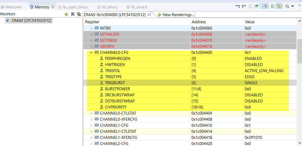

Hello Luca,
Sorry only through the part of code, I also haven't find the problem,
you can compare the DMA config registers between example  code with yours,
especially the Channel configuration registers:
You can also can delete your other codes, only includes the UART-DMA , I can help you check.

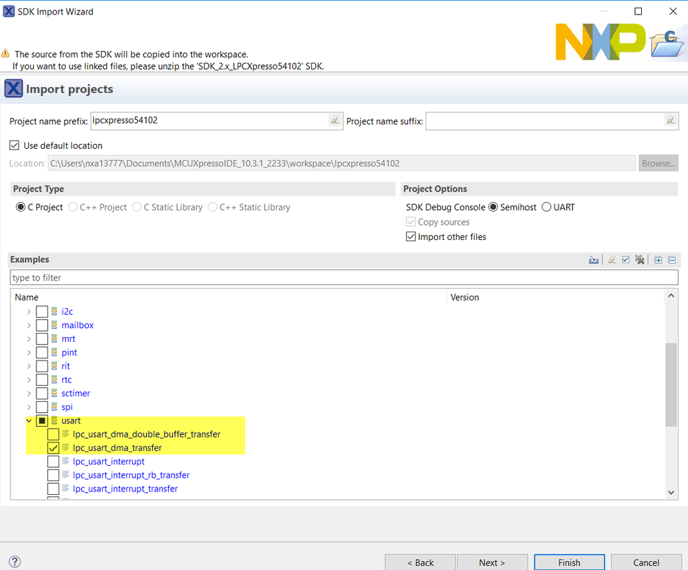

Hello Luca N,
There is UART DMA demo under SDK demo , you can refer to it :
TIC
