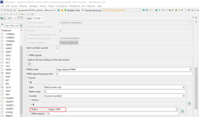

I am still trying to trigger DMA transfers with the SCT block, I have configured the DMAREQ0 to trigger with EVEN[1] that is match event, this is on the SCT side.
On the DMA/INPUT MUX side I have enable trigger request #2: SCT0 DMA REQUEST 0,  matching what I have described in the paragraph before and used the DMA_ITRIG_INMUX21 that is not tied to any of the UART, SPI or I2C.
I can see on debug mode that the bits needed are set and the trigger for sct is there but there's no transfer, can someone please help me figure it out what's the issue ??

Hello @skanda19
1) Have a look at the below thread:
https://community.nxp.com/t5/LPC-Microcontrollers/LPC82x-SCT-DMAREQ-example/m-p/1306321
Refer to SCT and DMA demo under SDK .
2) You can try to use MCUXpresso configuration tool to config SCTIMER trigger DMA:
