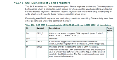

I have been looking for a clear, working example of the LPC824 SCT0 DMAREQ register working without much luck.
By my attempts, I can design a DMA channel that performs its task as long as the trigger is from software or a peripheral request, but once I attempt to wait for the SCT_DMA0 trigger it seems to never activate. In particular:
DMAREQ0 has bit 30 (trigger on L match reload) set.
DMA_ITRIG_INMUX0 is set to 0x02 (SCT_DMA0)
According to my understanding of the documentation this should generate an hardware trigger (on falling edge? - documentation is not clear) on DMA Channel 0 with HWTRIGEN enabled and PERIPHREQEN disabled. But on my code the trigger(s) seem to never arrive and the channel sits idle.

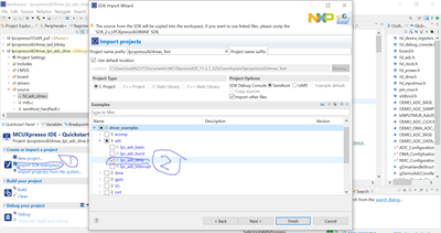

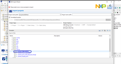

xiangjun_rong
Regarding how to generate the event based on SCTimer, you can refer to the SDK example
This is the code to generate event with match mechanism.

xiangjun_rong
I am sorry for misunderstanding you, now I see you want to use SCT event to trigger DMA directly.
Pls refer to the section:
The SCT->DMAREQ0[DEV_0] bits defines the SCT event source to trigger DMA.
Hope it can help you
XiangJun Rong
