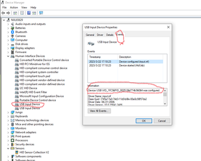

xiangjun_rong
This is my Device Manager screenshot after I connect to J3 usb port on LPC5536-EVK board with J43 configuration in the last Email.
Obviously, the PC can enumerate the USB.
XiangJun Rong

xiangjun_rong
For LPC5536-EVK board, close pin3&4, open pin1&2 for J43, connect J3 connector to USB of PC, run on PC:
blhost -u 0x1fc9,0x0025 get-property 1
is it okay or not?

AlbertoGarlassi
I found that on my board, for USB ISP, JP46's jumper should be put between 1&2. Default is 2&3.
Then USB enumerates as HID.
Does this mean that one more of the few pins of this MCU should be reserved for a voltage divider?
Why does USB performs normally with the standard jumper settings but requires USB0_VBUS for ISP?

xiangjun_rong
Okay, I see that the P1_31 pin functions as USB0_VBUS if you close pin1&2 of JP46.

AlbertoGarlassi
Yes it works,
Response word 1 = 1258488065 (0x4b030101)
Current Version = K3.1.1
9,216 Views
