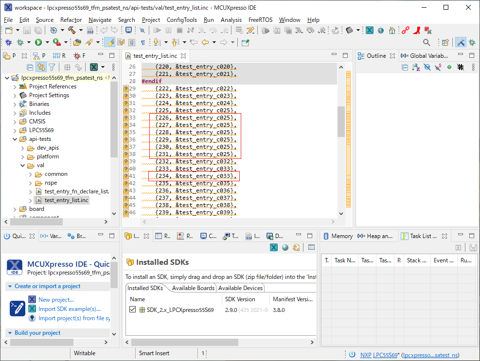

Hello.
I tried tfm_psatest_ns on LPCpresso55s69.
From "TEST: 226" to "TEST: 231" and "TEST: 234" are the same function is called.
lpcxpresso55s69_tfm_psatest_ns/api-tests/val/test_entry_list.inc
I think they are incorrect code.
If these are bugs, please fix them.
Thanks.

Hello ShinjiOhishi,
I edited my previous answer. I was confirmed that this is a typo and will be fixed on new releases of the SDK. Thank you for pointing this out!

Hello ShinjiOhishi,
Thank you for pointing this out.
It was confirmed that these are indeed typos. It was escalated to the SDK team know, and it will be fixed on future SDK releases.
My apologies for the inconvenience.
Gustavo

Hello Gustavo.
Thank you for fixing it.
