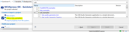

Hello @Arularasan,
Could you please check the following thread with a similar issue? Solved: I want to use USB conection to read files from pen... - NXP Community
Also, you could try using the USB examples from LPC54018 SDK, if you are using MCUXpresso IDE, click on Import SDK examples… and search for USB. You can download the SDK trough the IDE, or through the following link: MCUXpresso SDK Builder.
[MCUXpresso IDE Quickstart Panel and SDK Import Wizard]
It may be necessary to define which USB are you going to use: USB1 or USB0.
Best regards, Raul.
