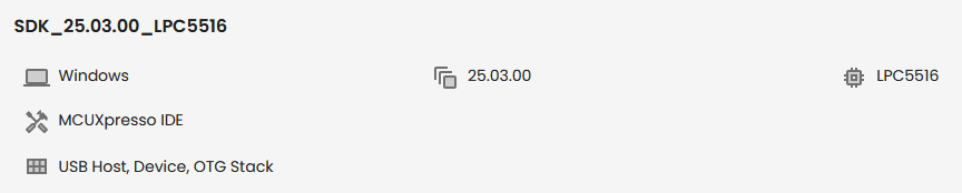

I use MCUXpresso IDE v24.12 [Build 148] [2025-01-10] with SDK 25.03 for LPC5516 configured as in the screenshot below

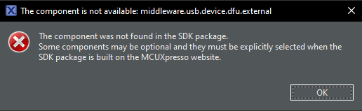

When adding middleware USBHSD, I get an error that an SDK component is missing. When trying to add this through quickfix, I get the following error
When clicking on the SDK entry, I can see that this component is available in the SDK.
How can I get that to work?

Hello @sigmeh
Please update the Config tools plugin in IDE by checking for updates (Help > Check for Updates).
However the update site is not enabled by default and must be enabled:

@Alice_Yangany updates on that? Current versions are not working, previous are, even with only USB checked when generating.

Hello @sigmeh
Thank you for your patience.
It is the same with yours on my side. I have escalated it to the MCUXpresso development team for further investigation.  I will keep you updated as soon as there is any progress.

sigmeh
I generated the SDK with everything checked but still having issues, even with a completely fresh project.
Also other peripherals have issues with adding the drivers.

sigmeh
Just also tested with 11.9.1 and SDK 2.16 and there it works for me.

Hello @sigmeh
Please choose all the drivers when downloading the SDK as shown below.
If you still encounter an issue, please take a screenshot or record a video to show how to reproduce the issue. I will checking it on my end. Thank you.
