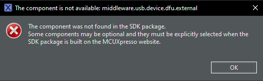

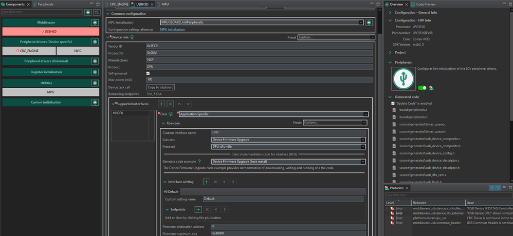

I use MCUXpresso IDE v24.12 [Build 148] [2025-01-10] with SDK 25.03 for LPC5516 configured as in the screenshot below
When adding middleware USBHSD, I get an error that an SDK component is missing. When trying to add this through quickfix, I get the following error
When clicking on the SDK entry, I can see that this component is available in the SDK.
How can I get that to work?

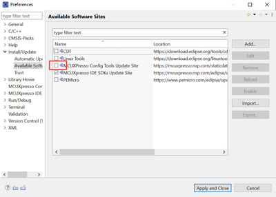

Hello @sigmeh
Please update the Config tools plugin in IDE by checking for updates (Help > Check for Updates).
However the update site is not enabled by default and must be enabled:

Hello @sigmeh

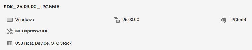

sigmeh
I generated the SDK with everything checked but still having issues, even with a completely fresh project.
Also other peripherals have issues with adding the drivers.

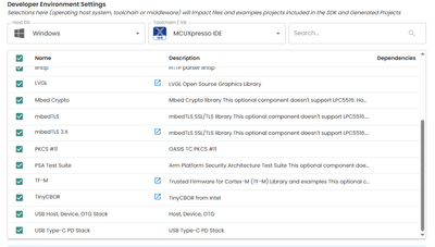

Hello @sigmeh
Please choose all the drivers when downloading the SDK as shown below.
If you still encounter an issue, please take a screenshot or record a video to show how to reproduce the issue. I will checking it on my end. Thank you.
