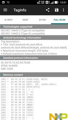

My Tag had write data(ABCDEFGHIJKLMNOPQRSTUVWXYZ123456).
Use NXP Taginfo APP can display all of data, please check attached file : NXP_TagInfo.jpg
The example code read data as below and it is lose data (56).

I don't understand how it concatenates all the data and then loses the last two?
Some one can help for this bug ?
