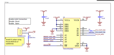

I am using the LPCXpressos55S69 board. I am probing the TX pin output on P2 on the board.
3,552 Views
xiangjun_rong
I see that you use LPCXpressos55S69 board, on the board, the P0_29/P0_30 are connected to P8 on the board. If you want to use the uart0 receiver function, you have to disable the switch by closing the P1.
Pls connect the P8 signals to scope and check if there is uart0 transmitting signal on the FC0_USART_TXD pin.
Hope it can help you
XiangJun rong
3,543 Views
ida
Sorry I misread the board. Yes I was always probing P8 and the TX pin. I've now added the jumper to P1. It now shows me the TX pin (next to ground) is 0 v always. Don't see it change at all.
Thank you
3,525 Views
xiangjun_rong
Can you use the example in the SDK package? if you select uart, the example use uart0 module.
XiangJun Rong
