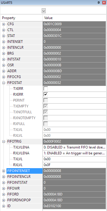

I'm unable to reset the RXERR-flag once it occurs.
clearing according to USART_TransferHandleIRQ() from USART driver version 2.0.3:
 /* Clear rx error state. */
base->FIFOSTAT |= USART_FIFOSTAT_RXERR_MASK;
/* clear rxFIFO */
 base->FIFOCFG |= USART_FIFOCFG_EMPTYRX_MASK;
RXNOTEMPTY, RXFULL, and RXLVL are changing to 0 and staying 0  after clearing rxFIFO. Executing "base->FIFOSTAT |= USART_FIFOSTAT_RXERR_MASK" in single step mode clears RXERR to 0, but one step later RXERR returns to 1. This even happens if the UART ist disabled before clearing. UART is idle and FIFO stays empty - RXERR = 1...
According to the manual, RXERR should only trigger if the FIFO overflows?! Disabling the rx-FIFO clears the flag, but on re-enabling RXERR appears again...

bjoernhaack
Hello Sabina,
I'm not using any of the examples. I modified the SDK for my own hardware. The UARTs are using the ringbuffer. The RXERR can be triggered by pausing and continuing the application. I attached some screenshots what happens in the ISR when I try to clear RXERR, single stepping through the ISR. The screenshots were made with an empty FIFO (RXLVL is 0 and stays 0).
Clearing does not always fail, but i have situations where the application is effectively blocked by the ISR trying to clear RXERR in an endless loop.
