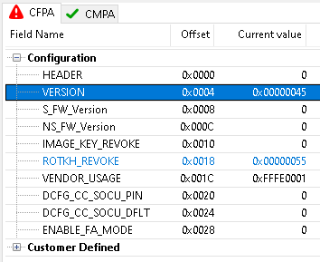

I have some issue with NXPDEBUGMBOX.EXE.
I've got an error when i try to connect to mailbox.
I made some try to find a way to use both SBKEK and USERKEK (if both are used, I can't load USERKEK on AES engine). nxpdebugmbox works fine until the end of the last week.
Since I've got this error.
I Have no "Customer Defined" value in both CFPA and CMPA
How Can I recover the debugmailbox connection?

Hi; I can't read it, I have "again" brick my dev kit  (I have 6 which are dead !!! ) trying to come back in unsigned mode using MCUXpresso Secure Provisioning. Blhost cannot ping device anymore anx nxpdebugmbox return

Hi @Aurelien_Grange
I hope to find you well!
Regarding your debug mailbox snapshot.
 I have seen this error whenever PIN and DFLT do not have their inverse value. Additionally, the Secure provisioning tool shows that PIN and DFLT in both pages are set two zero.
Regarding "Customer Defined" area not appearing  could you try to use BLHOST to directly read the CMPA and CFPA?

Hi @Aurelien_Grange
Unfortunately, if the debug authentication is failing and the ISP is not accesible the MCU is bricked, as you mention.
I already replied to your other post for embedding the SBKEK while using USERKEK, where I point your that it is posible to have both, My hypothesis is that the CMPA/CFPA used for while enabling the SBKEK did not have the inversed value on PIN and DFLT fields. So this derived in the problem you found.
Let me know if there is anything else we can check.
