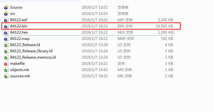

1.after build the project,i get hex and bin files.the hex file is ok ,but the size of bin file is up to 16M.
2. i use lpcxpresso 8.2.2 ide, and lpc1853 mcu.

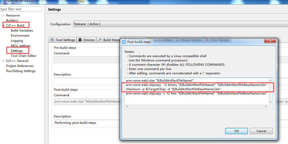

3. my config is below,could you tell me how  to config my projgect? thanks ,i will be waitting.

742791535
the link dosent give me a way to solve the problem.my question is that the bin file make by xpresso is too large up to 16MB,it's not the correct size.

Senior Contributor V
That’s the point. You can’t solve it (with a single bin file).
If you need bin files, you will need to creat two (or more) bin files - one for each non-contiguous memry region.
