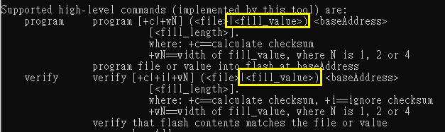

There are some option parameter in lpcscrypt tool for program to flash.
One option is use <File>, Can I use "stdin" method for this command?
There is another option <fill_value>? How to use it? does the fill_value must be a single fixed value for all fill byte?
Like: write 0xFF to 1, 2, 4... length?
Can you give me simple example?
Can I write a array buffer (example: [0x13, 0x34, 0x3d,....]) from another app.exe with this command option?

Hi Ken,
If you wish to write a particular pattern of bytes or words to flash, then there are two options:
1 - create a binary file containing the pattern and program this into flash in a single operation.
2 - use the flashset command - this takes arguments of <address> <word>. A script could be created that increases the address argument and passes in the new words as required. Note: flashset reads a sector of flash into RAM, erases the sector and then reprograms the saved data with the word modification - therefore this is not a fast operation.

Ken Su,
No, LPCScrypt doesn't have this feature.
parameter +w1, +w2 or +w4 are used to program memory with a 1-byte, 2-byte or 4-byte fill_value with an optional length of fill_length.
for example, if select +w1, with <fill_value> as 0xFF, all the address starts from base address will be filled 0xFF with the length of fill_length.
