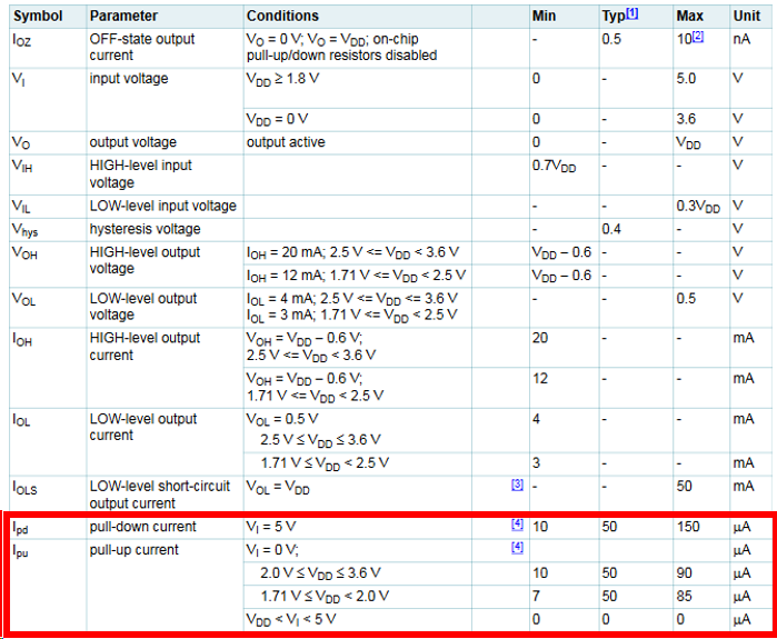

hello,
could u advise what the value of internal pull up and pull down resistor value for lpc804 is? thanks!
4,816件の閲覧回数
nxf51211
The pull-up and pull-down are not passive resistors but active current sources (they typically deliver around 50µA when enabled) that is why there is not a precise value for them. Please refer to the "Ipu"/"Ipd" and "Vi" characteristics in the LPC804 data sheet (Electrical pin characteristics, located at the Table 14, page 48):
So for example, if a pin at pull-down has a typical Vi of 5V, the current would be of 50µA and therefore the internal resistor value would be of 100 KOhms.
I hope this information can help you, and please ask if you have any more doubts.
Ricardo Delsordo.

how to configure the IOCON register and how to enable the pull down in pio0-7 in  lpc804? give the example
2,378件の閲覧回数
kangsenlu
To configure the IOCON register, you must first find the address of the IOCON register you are modifying. After you have the address, it is simple to simply use "*addr = value;" to change it.
However, you must first enable clock to the IOCON subsystem with "LPC_SYSCON->SYSAHBCLKCTRL0 |= (UART0 | SWM | GPIO | IOCON);".
I have noticed that although the user guide says the IOCON reset value is 0xb0, i.e. pull-up resistor enabled. But my own debugging indicates that IOCON value was reset to 0. So I have to manually set that IOCON register with my code.

kangsenlu
After some more investigation, I found that we must turn on clock to the IOCON subsystem. Otherwise, the chip will NOT automatically set the IOCON register to the default value of 0xb0.
