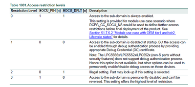

The AN13037 description of the DFLT / PIN configuration seems to conflict with the user manual
It says
and
I interpret this to mean that setting the DFLT / PIN to 1/1 gives access to the specific sub-domain and that a CFPA cannot set a lower restriction level to a subdomain than what was set in the CMPA.
However, the User Manual on page 975 says that a DFLT / PIN setting of 1 / 1 has the highest restriction level and disables access to a submodule.  I also assume that if the CMPA configures one of the submodules as 1/1, then the CFPA wouldnt be able to set it to a lower configuration.
It would be very nice to get clarification on this.  Based on descriptions within this forum, it seems like what is described in AN13037 is wrong.

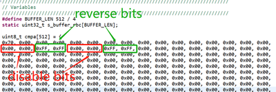

It's not correct. I have reported this.
Please refer table in UM11126. this is correct
The default CC_SOCU_PIN and CC_SOCU_DFLT in PFR are all zero, and not satisfied with the inverse rule, so the ROM will open all debug permission at this condition.
Bellow setting disable the access.
Hope this helps,
Jun Zhang

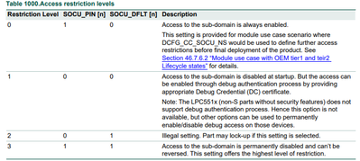

DWightman
It looks like I was looking at the wrong manual, and it was for the LPC55S0x  (UM11424).
And as you say the UM for the LPC55S69 (UM11126) is showing the same as the AN.
3,328 Views
ZhangJennie
yes, please refer UM11126. This is correct.
For other manual problem, I have reported it.
