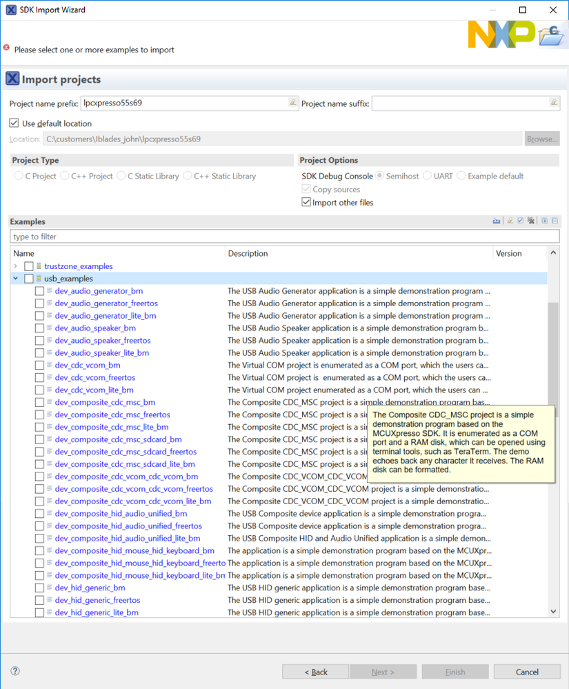

dear LP55s69 ,
In the SDK, which USB demo code demonstrate the HS capability?
My customer I-Blades is looking for the dev_msc_sdcard_bm code but he want to use high speed usb port.

Hello Hy Mai,
I just test on my side, it is easy change the demo dev_msc_sdcard_bm to HS USB:
Only need change the code in usb_device_config.h file:
/*! @brief LPC USB IP3511 FS instance count */
#define USB_DEVICE_CONFIG_LPCIP3511FS (0U)
/*! @brief LPC USB IP3511 HS instance count */
#define USB_DEVICE_CONFIG_LPCIP3511HS (1U)

chrisgulick
I have been able to change the USB from full speed port to the high speed port but did not try to set to high speed.

Hello Hy Mai,
Sorry It seems there isn't USB High Speed demo for LPC55s69 so far.
