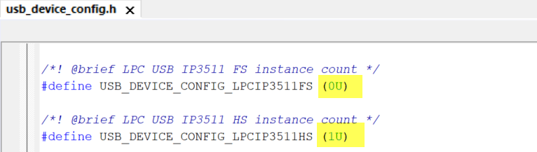

hi,
i am trying to configure usb1 for hs usb cdc mode on a prototyped board using the lpc54608.
starting from dev_cdc_vcom_lite_bm,  I have set serial_port_type_usbcdc =  1, and usb_device_config_lpcip3511hs =1, while setting
#define USB_DEVICE_CONFIG_LPCIP3511FS (0u)
#define SERIAL_PORT_TYPE_UART (0U)
these are defined in serial_manager.h and usb_device_config.h
the first problem to arise is that, upon setting the port type to usbcdc rather than uart, I am unable to build.  second, if I prevent error from happening, I am still unable to connect.  so, I am wondering, what steps am I missing to configure usb1 for cdc.
thank you!

ZhangJennie
Hi Eileen Radzwion,
Just tested SDK2.6.0 dev_cdc_vcom_lite_bm demo with IAR.
The default demo use FS USB0 as composite VCOM. In order to change to HS USB1, I modify USB config setting as below:
rebuild the project and download. USB1 can be recognized as two VCOMs.
See my attached testing video.
Jun Zhang

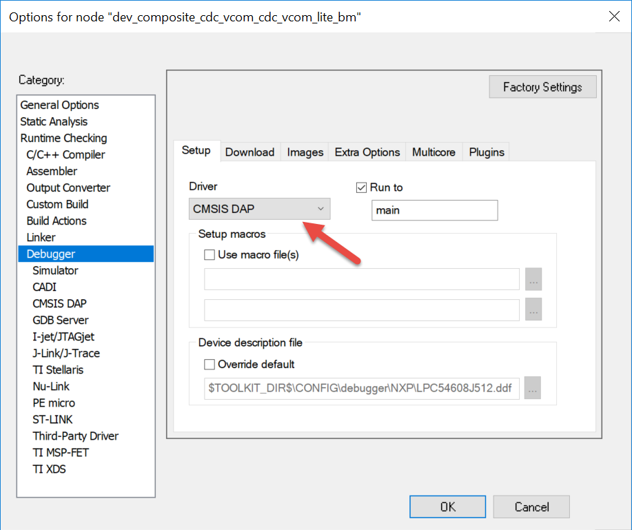

ZhangJennie
In your previous email, you said you were not able to build. If you can make the project pass build. please follow the video to pass build first.
If build successfully, make sure you choose the correct debugger driver. For example, I use CMSIS DAP interface, I set driver as CMSIS DAP.
Jun Zhang
