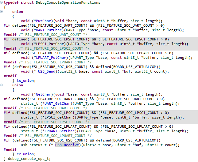

If you check in this file you will find a DebugConsoleOperationFunctions structure that define functions for debug console, so inside here I define a USB_Send and a USB_Receive:
DbgConsole_Init function is called to set the function pointers to the function that will handler the read and write function, inside this function you can find a switch case that use for example DEBUG_CONSOLE_DEVICE_TYPE_UART or DEBUG_CONSOLE_DEVICE_TYPE_LPSCI. This macros are defined in fsl_common.h, here you can also find a DEBUG_CONSOLE_DEVICE_TYPE_USBCDC, so I used this to add the case branch.

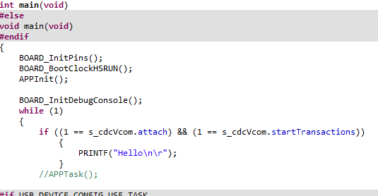

And this is all that you have to do to defined your send and recieve functions, now in main() you find a BOARD_InitDebugConsole(); and inside you see that they used the DbgConsole_Init that we have previously modify, so I changed as:
void BOARD_InitDebugConsole(void)
    uint32_t uartClkSrcFreq = BOARD_DEBUG_UART_CLK_FREQ;
   // DbgConsole_Init(BOARD_DEBUG_UART_BASEADDR, BOARD_DEBUG_UART_BAUDRATE, BOARD_DEBUG_UART_TYPE, uartClkSrcFreq);
    DbgConsole_Init(BOARD_DEBUG_USBCDC_INSTANCE, BOARD_DEBUG_USBCDC_BAUD, DEBUG_CONSOLE_DEVICE_TYPE_USBCDC,0);
(you going to need to define BOARD_DEBUG_USBCDC_INSTANCE and BOARD_DEBUG_USBCDC_BAUD)
Now as this function used s_cdcVcom.deviceHandle I need VirtualCom_Init() to be called first, so in main
APPInit will call it.
I implemented a basic PRINTF("Hello\n\r"); to prof my program:
