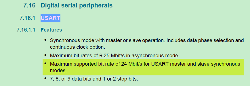

Content originally posted in LPCWare by frankeggink on Fri Apr 01 06:06:03 MST 2016
What is the maximum uart baudrate that can be achieved with the lpc54102?

huangzhonghao
I want to know the maximum uart baudrate with lpc54102 too, did you solve your problem?

kerryzhou
Hi Huang Zhonghao,
  Actually, you can find this information from the LPC54102 datasheet:
24Mbit/s
Wish it helps you!
Kerry
