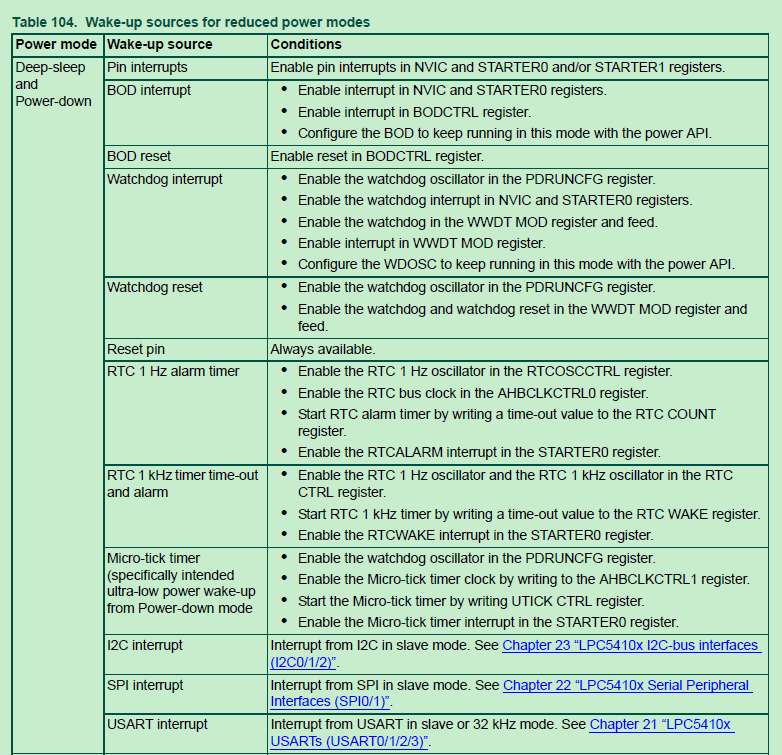

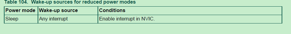

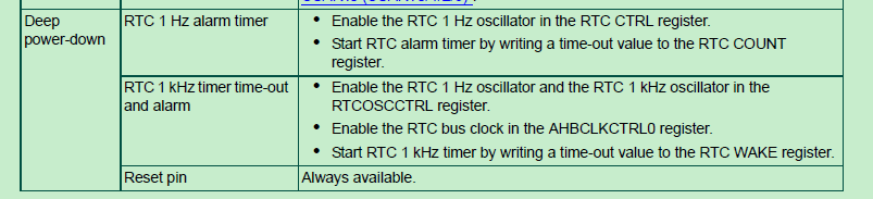

   What the power mode you are entering?
  From the user manual, you can get the wake up source for each low power mode:
So, if you enter deep power-down mode, you can't use the pin interrupt to wake up.
Please check you power mode at first.

I am using SLEEP mode.
#define PDOWNMODE   (POWER_SLEEP)
Yes, I did register the interrupt to NVIC.
/* Enable interrupt in the NVIC */
    NVIC_EnableIRQ(PIN_INT0_IRQn);
