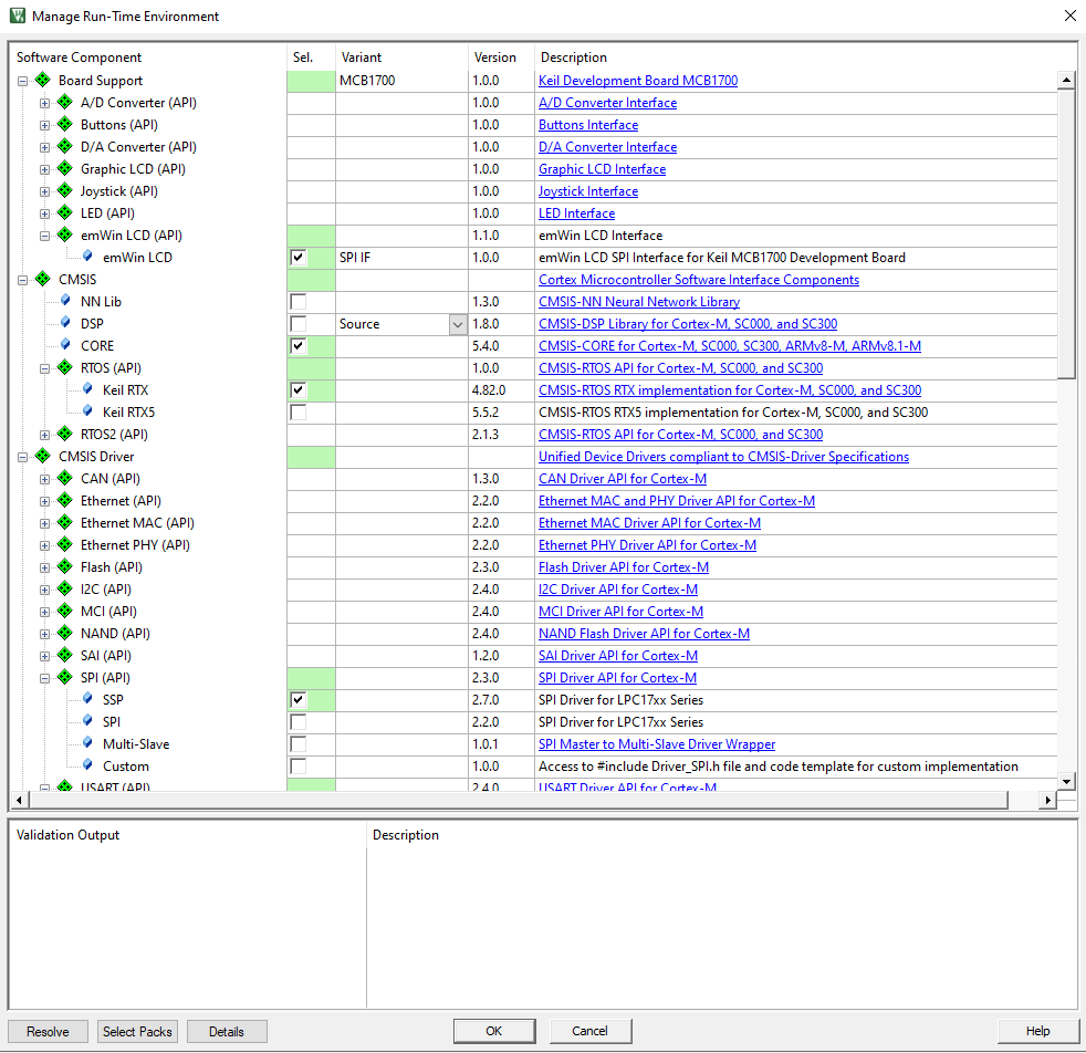

I'm working with an LPC1768(FBD100) and need to connect to a PC through a serial USB. As a starting point, I used the sample package USB virtual com port.
Installed packages:
My code:
[code]

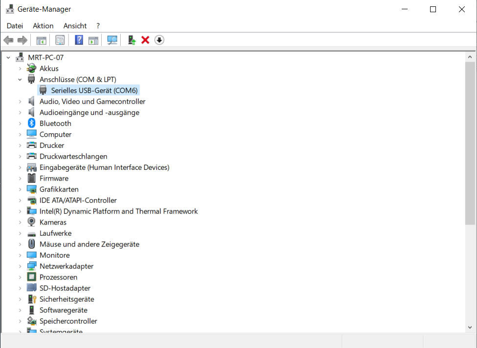

// Works as expected ; new COMx device shows in dev manager.
USBD_Initialize (0U); // USB Device 0 Initialization
USBD_Connect (0U); // USB Device 0 Connect

Why does USBD_Connect() hang? no code gets executed past that point; the device does connect, however, to the PC:
rl_usb.h contains the definitions of USBD_Initialize() and USBD_Connect():
[code]
/// \brief Initialize USB Device stack and controller
/// \param[in] device index of USB Device.
/// \return status code that indicates the execution status of the function as defined with \ref usbStatus.
extern usbStatus USBD_Initialize (uint8_t device);
/// \brief Activate pull-up on D+ or D- line to signal USB Device connection on USB Bus
extern usbStatus USBD_Connect (uint8_t device);
[/code]
These are function declarations; I don't know where the implementations are (likely in USB_CM3_L.lib).
Read/write functions are defined in USBD_User_CDC_ACM_UART_0.c

I've managed to get it to run but have another problem with keil's component manager and made a post but it's currently pending.
Best,
Kev
