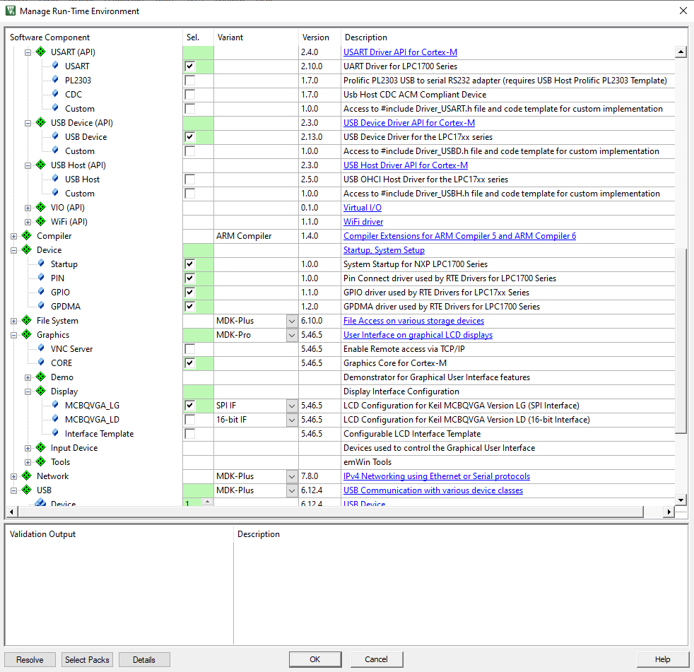

I'm working with an LPC1768(FBD100) and need to connect to a PC through a serial USB. As a starting point, I used the sample package USB virtual com port.
Installed packages:
My code:

Why does USBD_Connect() hang? no code gets executed past that point; the device does connect, however, to the PC:

Is it possible to run the lpc1768 as a USB listener and also perform a set of tasks in parallel? If yes, how should I go about it?
ラベル(3)
4 返答(返信)
3,289件の閲覧回数
Alexis_A
Hello Kevin,
What do you mean about a USB listener? Do you plan to use one of the USB instances as host and the other as a device and process the packages in the middle of a USB communication?
I think this will be a little difficult to do this with this MCU. The speed to receive the messages and interchanging it between them with the frequency used by the USB will be a little difficult with the core frequency and will not leave much time for other tasks.
Alexis Andalon
3,289件の閲覧回数
kevinr11082005
>What do you mean about a USB listener? Do you plan to use one of the USB instances as host and the other as a device and process the >packages in the middle of a USB communication?
No, it's a direct link between a master and a slave that talk through a VirtualCOM port over USB.
Thx!
Kevin
3,289件の閲覧回数
Alexis_A
Hello Kevin,
This MCU has a ROM library that implements some of the functions so you only need to fill the structures and the ROM code will do all the work.
Since you don't have two cores in this MCU you can't run the task in parallel but you could use some kind of synchronization or an RTOS (there's a FreeRTOS example in the LPCOpen).
Alexis Andalon
3,289件の閲覧回数
kevinr11082005
I've managed to get it to run but have another problem with keil's component manager and made a post but it's currently pending.
Best,
Kev
