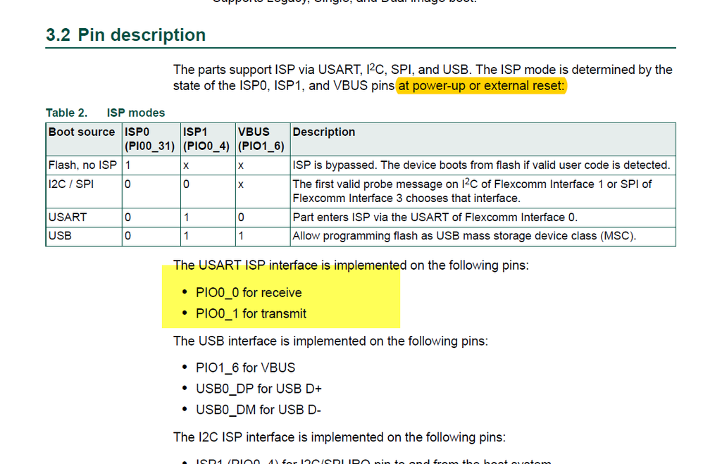

Is an RTS pin valid also in ISP mode?

   Unfortunately, in ISP mode, the UART just support UART_TX and UART_RX, no RTS is used, please check this information from the user mannual:
So, if you have the demand to use the RTS pin, maybe you need to create the secondary uart bootloader.
Wish it helps you!
Kerry

Dear Kerry,
Thank you for the kind explanation.
I see.
George
